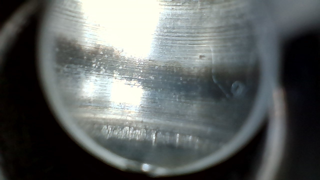

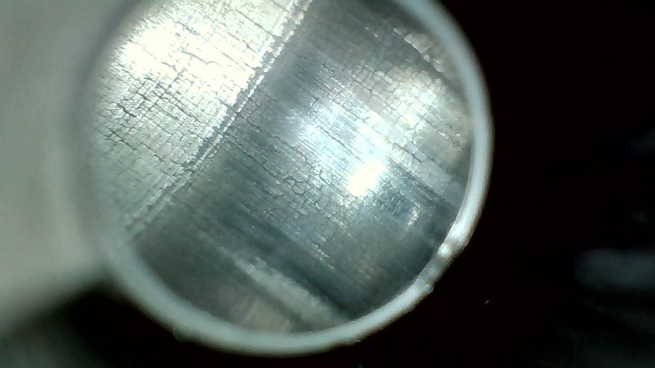

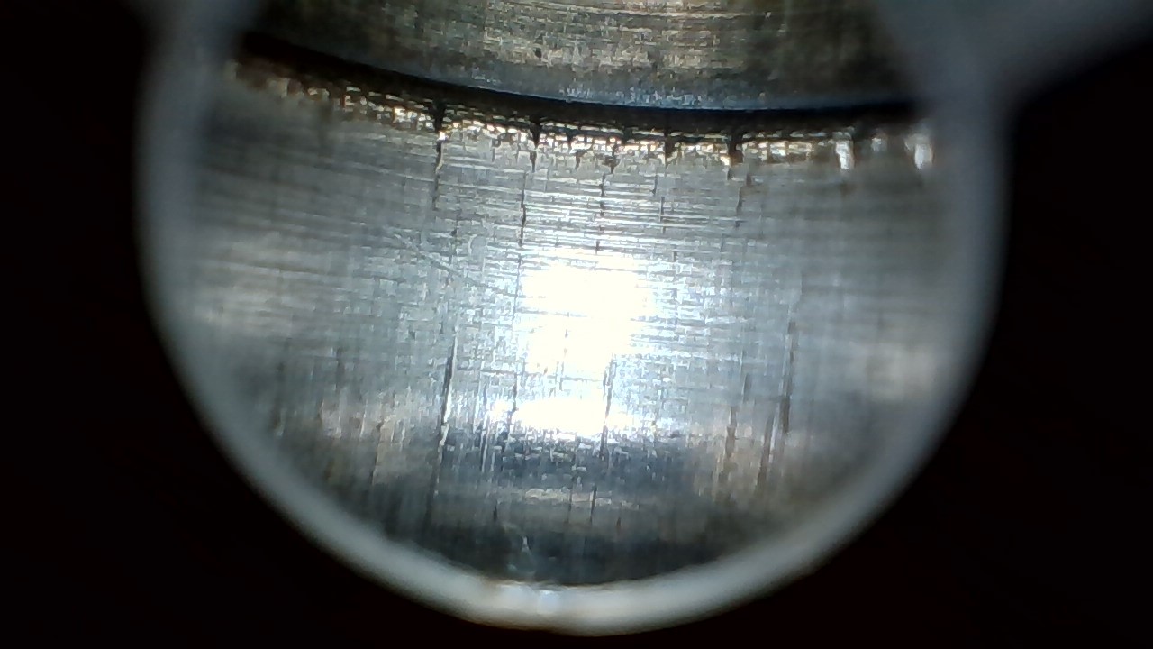

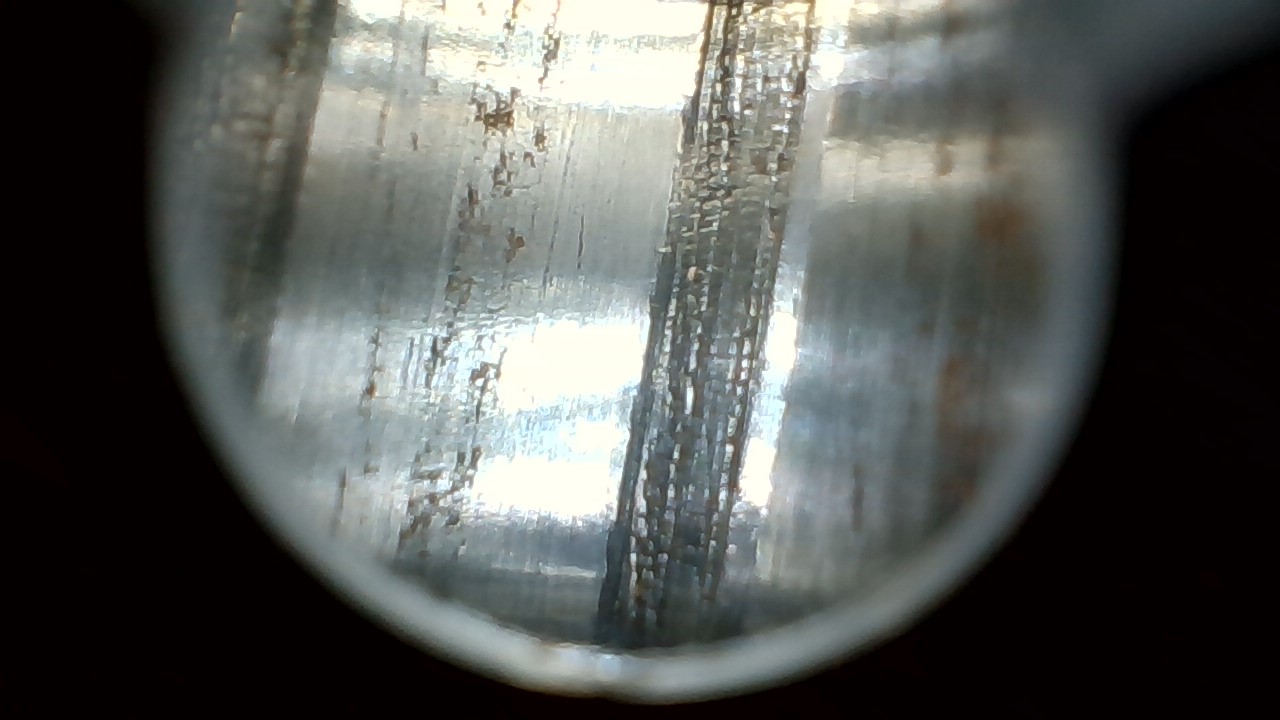

here is a few of those pics.
Odd ring in the neck area of the chamber....a chamber brush and some solvent got it out.
This is a bad carbon ring...this is probably responsible for more guns losing accuracy and shooting like crap......VERY HARD to get clean.
This is a 308 barrel that belongs to the local SWAT guy ...notice the carbon is mostly gone but the firecracking has stripped some copper off the jackets. A good copper solvent and scrubbing took care of this.
This one of my barrels with about 1200 rounds on it....carbon ring is in check and no carbon or copper build up in the throat area. Firecracking or alligator hide usually starts to show up around 100 or so rounds.
