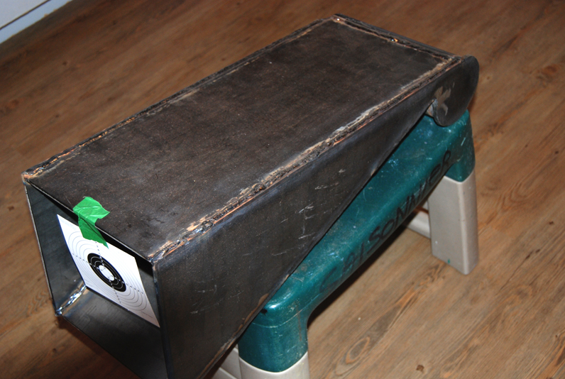

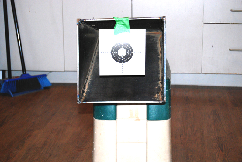

I've been to the local welding shop yesterday, I had this idea for a while now and it was high time to do something about it.
It cost me $60 it's all made of 3/8 thick steel, the pipe could be a 1/4 but at this point who cares right. It's a little heavy though.
I've tried it a few times it's perfect. I wanted it to be standing upright but there was a little lack of communication with the welder who had never saw anything like this lol So i'll use it as seen on the pictures. I'll see if I can whip up something for the open end, originally I wanted to use a coffee can to collect the lead if it was standing but it looks a little weird standing but i'm sure it will do the job any way you put it. (Target is 6 inch square)
It's a little rough, but it was cheap so I'll do the grinding when.... ever lol
I probably should've put it in the "air gun" section since it's "officially" a pellet trap ... 40 Gr. pellet ;)

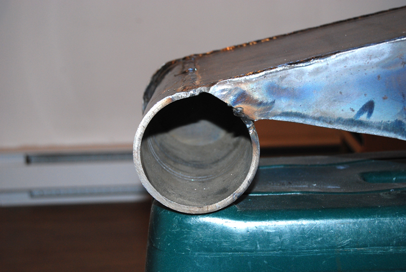

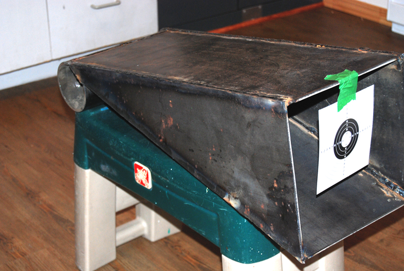

.22's have already been tested, splats on the bottom without even a scratch and rolls in the tube, the angle although I wanted it more open (like 70 degrees) to use less steel and less weight does all the work at about 45 degrees and very long (third pic 1st post). I have no doubt it would work as well for any 9mm FMJ and .45's. The tube in the back is at least 1/4 inch thick and the top plate is welded as if it was part of the tube so no direct impact on it, even if you shot directly in the slot, it would roll but it would be hard since it's almost horizontal (fourth pic 1st post). I love it so far.
